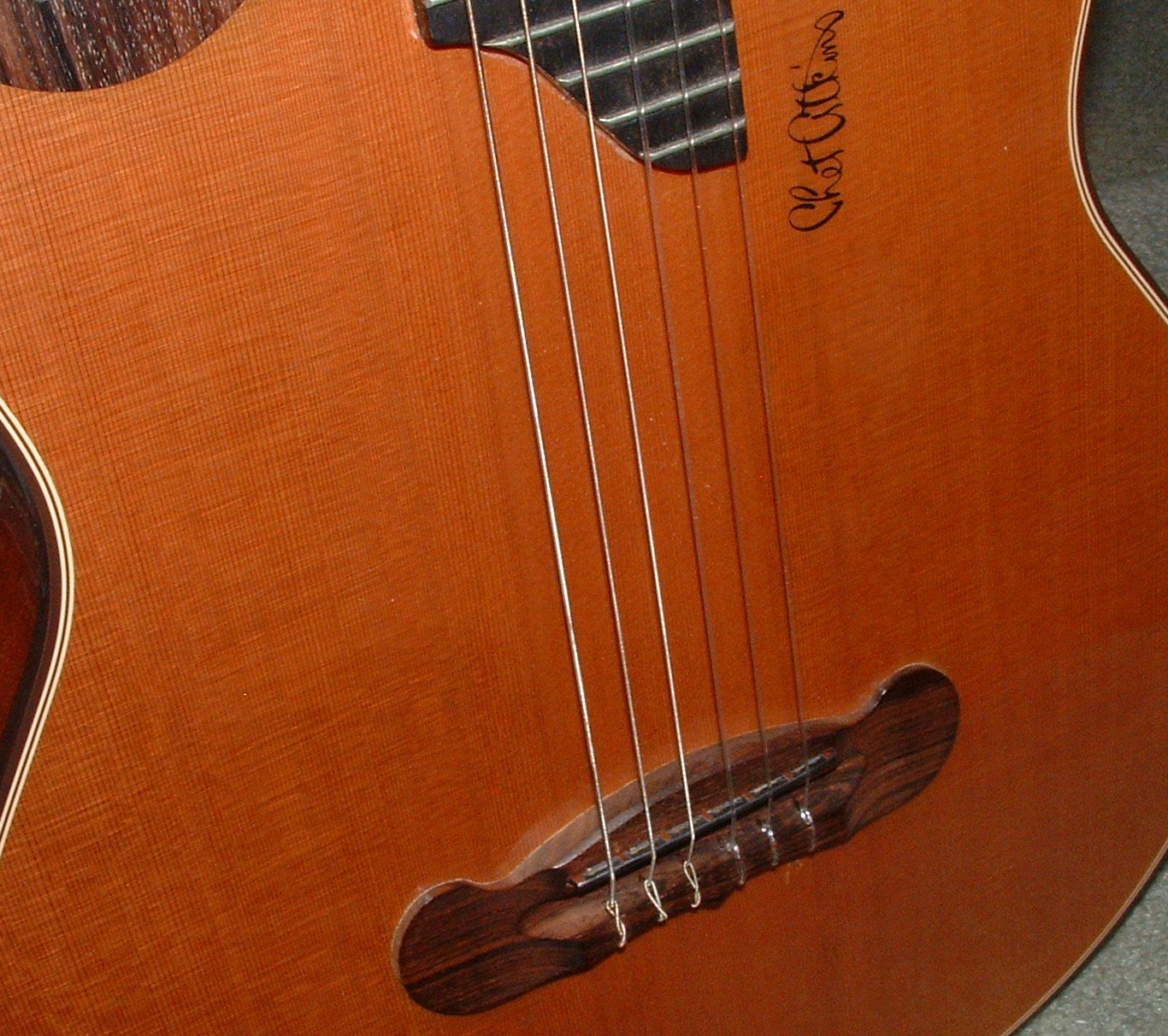

I know You would rather use original replacement for the pickup, and the Ovation will fit, Only thing I'm not sure of is if the electronic's are a match. I have a 2005 Gibson Studio and replaced the saddle and EQ. with the Barbera and it was a big change for the better. But the 2005 has an 1/8th inch saddle so You would need an incert with a slot for the thinner saddle, and that's not a big deal. I have an Ovation pickup I found on ebay just as a spare for My 1993 Gibson Studio should it ever have problems. This picture shows what a Barbera saddle looks like in My 2005 Studio.
