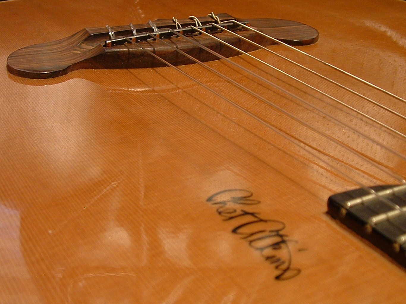

New saddle

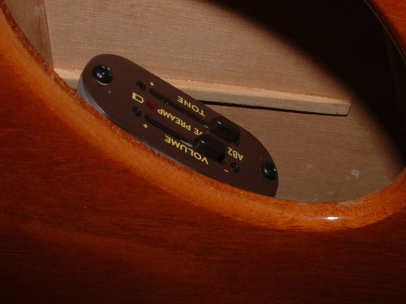

New preamp

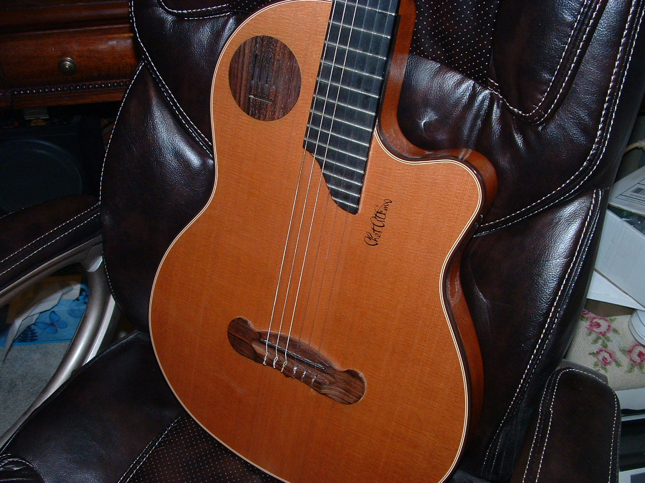

I'm not sure if all the Montana Chet Atkins Studio CE's sound the same as My 2005 did, But I was not happy with the sound quality of the preamp or the pickup. The Guitar is the same as the older Studio built and woods used. But until I replaced the pickup and preamp with the Barbera pickup and AB2 active preamp, it was a 100% change in sound. It now sounds as good or better than My older 1993 Gibson Chet Atkins Studio CEC. I can compare them because I have both, and when I purchaced the 2005 studio, I couldn't believe the electronics could sound so bad for a 4,000 dollar guitar. It now sounds like it should have from day one. I wrote this for those Who own This model don't get ridd of this very well built guitar it just need,s better electronic's other wise it's a beautiful instrument.
The main reason for this post is, I see people selling these models cheap,($1,500.00 ), " GRAB IT " they listed for over $4,000.00 and only made for a five year period.

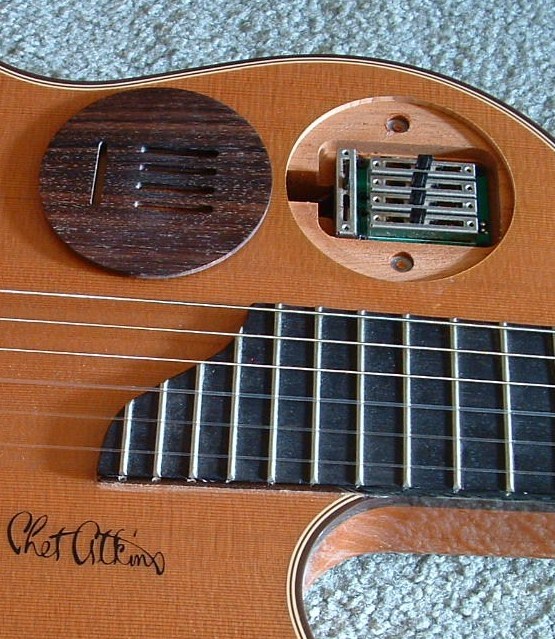

Hi Phil, In that case they didn't respond. But I had questions on another Gibson I thought might be a fake, and they asked for pictures and meassurement's, and siad it was infact a real Gibson BB King Lucille. All within a few days. They also told Me how to take the cover plate off the EQ. of the Montana Studio CE when I asked how to get at it. I was supprised how easy it is, two small magnets hold it in place just put Your fingernails in the slots and lift straight up. I hope this don't mean I'm going to get struck by lightning LOL.
I I posted a picture of the cover removed and the two round magnets.
