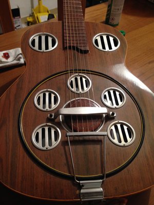

Finally was able to find a Del Vecchio that was playable. It looks to be an older one with Dancing Note logo on the headstock. Somewhere along the way over 55+ years, the resonator cone was replaced with a non DV unit which required attaching the biscuit via screws. It sounded OK, but a bit dead. I was able to get a replacement Paul Beard Delvecchio cone and it now sounds a whole lot better.

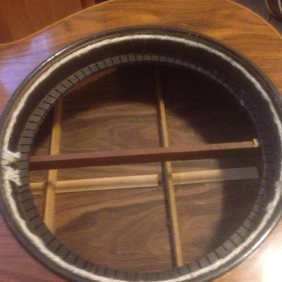

Here's some images of the inner workings of the Delvecchio taken during the cone replacement:
1. The biscuit with screws!!!
2. Wooden sound well: note the hi-tech string!
3: A peek inside looking forward to the neck:

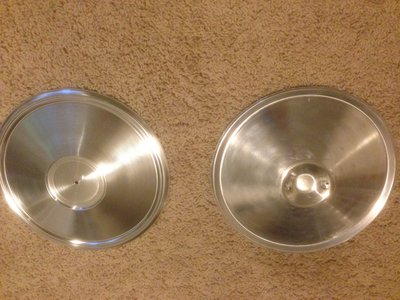

Postby Douglas » Wed Jun 08, 2016 6:15 pm
And lastly, the new vs old cone. (note the screw holes and difference at the top of cone):

Postby Norm » Wed Jun 08, 2016 6:41 pm
I'd be willing to bet the resonator on the right was not original to the guitar because the puck that is the bridge base on those things is more like the one on the left over 2" wide if I remember correctly
It's like the previous owner got a resonator either from Del Vecchio intended for a different model or something. In any case, the one on the right looks wrong in too many ways

Postby Douglas » Thu Jun 09, 2016 1:20 am
Norm wrote:I'd be willing to bet the resonator on the right was not original to the guitar because the puck that is the bridge base on those things is more like the one on the left over 2" wide if I remember correctly
Note to Steve Sanders
Beard has the things. You just need to root around in their website a little deeper
http://www.resophonicoutfitters.com/category/016.html
Norm,
My thoughts exactly on the cone. The original probably got collapsed and the owner got something that "sort of worked". The biggest problem I had with the new cone in the bridge ended up being to low, since the previous owner shaved it to compensate for the taller apex on the nonDV cone. Had to shim up the bridge about 3/16ths. The action is good on this DV, on par with a Taylor or Martin.

Postby Spadaro Paolo » Thu Jun 09, 2016 9:35 am
I'd like to know how to open the wooden lid, the lid that hides the hole where there is the cone, so as to inspect my aluminum cone. It needs to remove a seal?
Grazie, Paolo.

Re: New Delvecchio
Postby Douglas » Thu Jun 09, 2016 11:24 am
Paolo,
That yellowish ring that sits on top of the outside of the resonator cover plate is a retaining ring to hold the cover on and eliminate any rattles and buzzes. Basically a plastic/vinyl coated spring steel wire. Looking at your photo, it appears the ends of the ring are at about 11:o'clock in relation to the top hole on the cover plate.
If you remove the retaining ring the cover plate should lift off easily. Putting the cover back in is easy but....the retaining ring is frustrating at best to get back in place. Probably would be better to inspect the cone by looking through the sound holes with a flash light. If it looks OK and more importantly if it sounds the way you wants, I'd follow the advice of my late father: "if it ain't broke, don't fix it". Just my opinion based on a few frustrating hours last weekend.
